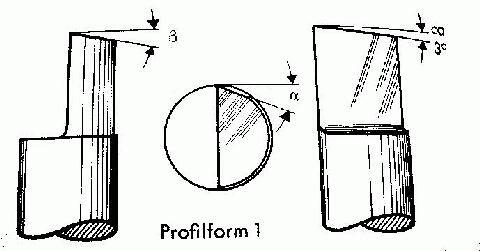

how to make an engraving cutter of an old drill - step by step.
1 use the shaft of an old drill
2 make it half.
3. make the top.
4.
5. finish -> make back free
4. look to middle one
here above
