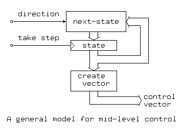

All hardware solutions to generating the control trajectory are subsumed by the general model illustrated in Figure 6.1:
Figure 6.1The next-state and create-vector blocks in Figure 6.1 are combinational logic functions, while the state block is a register. Depending on how the state is encoded, the create-vector function may be trivial; for certain applications, the next-state function is also trivial, but in the general case, next-state becomes an up-down counter while create-vector becomes a ROM holding the sequence of state vectors needed to form the control trajectories.![]()
It is worth noting that some stepping motor control systems include addtional inputs to the mid-level control system. Common additions include half-step and brake inputs. Braking control is meaningless in full-step mode but it is of some use in half-step mode. In the latter mode, shorting unused motor windings at low speed is an excellent way to limit resonance while at higher speeds, unused motor windings should be left open for efficiency. Finally, some motor control systems include a disengage input that removes power from all windings; in this case, if brake is asserted, it typically shorts all motor windings.

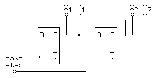

Amature astronomers frequently need very slow motors to turn their telescopes, and in recent years, stepping motors have taken the place of synchronous motors and gear trains for many applications, particularly for barn-door or Scotch mounts, a class of extremely simple camera mounts used in astrophotography. For this application, circuits as simple as that shown in Figure 6.2 are common:
Figure 6.2The circuit shown in Figure 6.2 only operates in one direction, generating the signals needed to turn a permanent magnet or hybrid motor one full step for each pulse on the take-step input. In terms of the general model in Figure 6.1, the next-state and create-vector functions are trivial and require no logic to generate so long as each flipflop in the state register has outputs available in both straight and complemented form.![]()

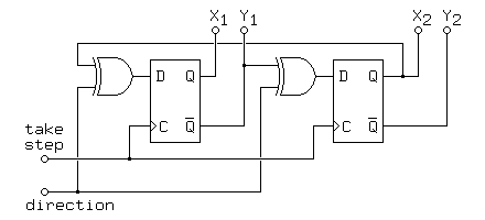

Modifying this circuit for bidirectional operation is straightforward, as is illustrated in Figure 6.3:
Figure 6.3The circuit shown in Figure 6.3 uses two exclusive or gates to compute two different versions of the next-state function, depending on the value of the direction input. Each flip-flop presents both inverted and non-inverted outputs to the world; this allows an equivalent circuit to be made by substituting a double-pole double-throw switch for the exclusive-or gates, and another equivalent circuit can be derived from this by substituting a pair of 2-input 1-output multiplexors for the switch.![]()

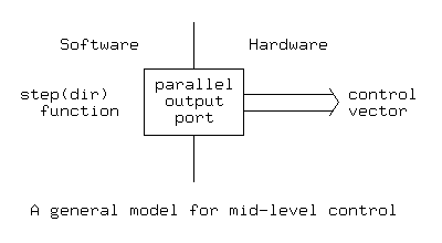

If a microprocessor, programmable interface controller or other computer system is used to control a stepping motor, the computer can directly generate the control vector in software and present it to the motor interface through a parallel output port, as shown in Figure 6.4:
Figure 6.4In this software-centered model, the basic problem of mid-level control is reduced to how the step function is implemented. Each call to step(d) causes the control vector to advance along the control trajectory in the direction specified by dir. The call step(+1) causes the motor to step forward, while the call step(-1) causes it to take one step back.![]()
