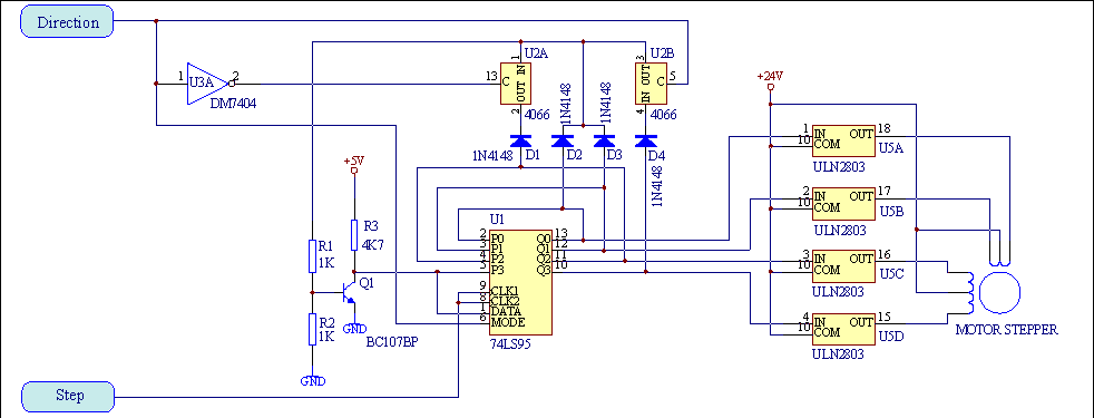

Here are another three examples for electronic stepper motor driver.
These circuits are built from standard components and can easily be adapted to be controlled by a computer.
Two-Coil Excitation - Each
successive pair of adjacent coils is energized in turn.
A variant of above circuit....
Single-Coil Excitation - Each
successive coil is energized in turn.

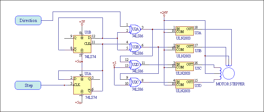

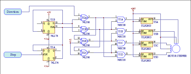

In this variant I used some ordinary components, available in large number in my "micro workshop"
All variants was tested and I found only very small and insignificant differences in results.
